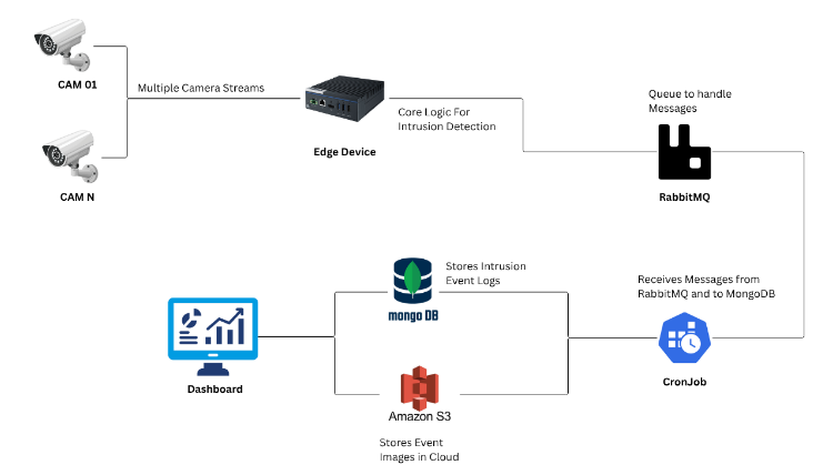

Architecture
You can see the architecture diagram

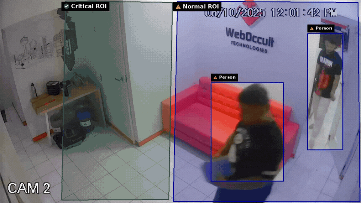

Functionality:
  • Continuously monitors designated areas using live video feeds
  • Difference between two levels of intrusion zones:
    • Critical ROI (Danger Zone): Alerts are sent more frequently and faster, as this region represents a high-risk or dangerous area
    • Normal ROI (Warning Zone): Alerts are sent less frequently, indicating a potential but non-critical intrusion
